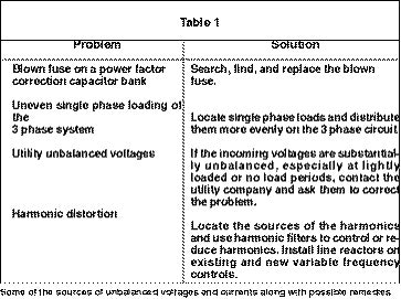

What creates unbalanced currents?
In years past, if the motor was not the problem, the source of unbalanced currents was always unbalanced phase voltages. Detectable differences in the line-to-line voltages (A to B, B to C, and C to A) would be present. The voltage differences accounted for the unbalanced currents.
In this high-tech world of ours there are other problems that frequently are not detectable using a simple voltage test. One problem of growing concern is voltage distortion caused by harmonics in the power system currents. The harmonics originate in loads in the general area that draw nonlinear, harmonic rich currents from the power system. This distorts the normal voltage sine-wave. The distortion can cause unbalanced currents in motors even when phase voltage differences are not detectable with a voltmeter.
For example, if you suspect unbalanced motor currents and rely on measurements taken with a digital voltmeter, the phase-to-phase readings might be very close to one another. Under these circumstances, the natural tendency is to blame the motor for the problem. But, before you go off half-cocked, go a step further and identify or dismiss the motor as the source of the problem.

How much unbalance can you tolerate?
In general, this depends on the conditions you find. If the motor is driving the load well and the highest current in the three legs is below the nameplate full load rating, then it is generally safe to operate the motor even with any unbalance.
If the current in a leg is higher than the nameplate rating but within the normal service factor (normally 1.15), then it is probably still safe to operate the motor.
Also, it is not unusual to find currents more unbalanced at no load than under load. If this is your situation, use the amperage values taken when the motor is loaded. Finally, in general, if the high current leg is less than 10 percent higher than the average of the three legs, then it is probably safe to operate the motor.
