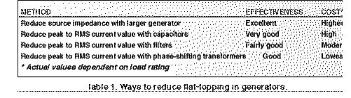

When using PWM drives, current only flows during a portion of each half cycle. For a given RMS value, peak current is greater than for a normal current sine wave that drives a current flow during the full half cycle. This larger peak value causes a greater voltage drop within the generator. There are a few ways to reduce the flat-topping. One approach is to increase the size of the generator so that the actual voltage drop across the internal impedance of the generator is small. This is the highest cost solution.
The other approach is to reduce the peak to the root mean square (RMS) value of the demand or load current. There are a number of methods to accomplish that reduction. The first and most costly method of reducing flat-topping would be to add capacitors at the terminals of the generator. The capacitors must be sized to handle the expected load current or kVA of the load. A second, and less costly, method would be to add a filter (a small series inductance and shunt capacitance) rated for the expected kVA load. Some filters are designed to supply peak load current while the generator sine wave voltage is at the peak value. These capacitors are "recharged" when the generator is not supplying current to the load.
The third, lowest cost method is to divide the nonlinear loads into groups that take power from separate voltage sources. Adding a transformer between the generator and the loads provides this voltage separation. The transformer needs two secondary windings. One winding, configured as a wye or star, supplies the voltage for one load group. The other winding, configured as a delta, supplies the voltage for the other load group and is phase-shifted from the first winding by 30 degrees. Phase-shifting the voltage sources decreases the peak RMS value and reduces flat-topping of the generator terminal voltage. Because the current pulses for each load group are displaced in time, the RMS value of current increases but the peak values do not add. Additional load groupings and phase shifts continue to reduce the peak current. The no-load losses of the transformer must be considered as part of the total load on the generator. It is important to remember that line-to-line variations result in unbalanced phase currents. If too great a voltage imbalance exists, then the highest line-to-line voltage experiences the highest RMS and peak current so flat-topping will persist.
