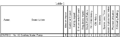

Click to enlarge Table 1
Using the Table 1 example, we can deduce that the “No. 12 Cooling Water Pump” is a critical asset as it falls within the top 20% guidelines, but the score of ‘80’ alone tells us nothing about how to manage this “critical” asset.  Through further analysis we are able to conclude that by reducing the consequences associated with a single-point-failure, through Single Minute Exchange of Die (SMED), ready service spares, or properly managed critical spares inventory, we can lower the criticality ranking, allowing the reliability group to focus their efforts on the truly unreliable.
