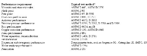

Table 1. Lubricant characteristics and the laboratory test methods to gauge them. Click to enlarge.
