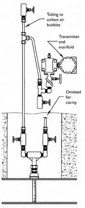

Non-standard orientation
Occasionally, it’s not practical to mount the pitot tube in the recommended orientation. For example, a buried water line does not allow access to the lower portion of the pipe; therefore, the instrument must be mounted to the top. In such cases, special mounting considerations prevent entrained air from collecting in the instrument lines or transmitter (see Figure 5).
Figure 5. Buried water pipe

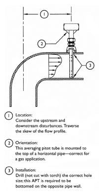

Figure 11 summarizes the most important points of a good installation. If you follow the basics of location, orientation and installation, you can ensure accurate long-term performance.
Figure 11. Correct installation summary (side view)
