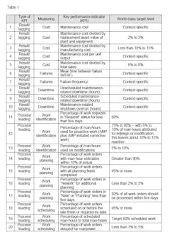

Table 1 lists some KPIs I prefer to use, along with the world-class level where applicable. Leading indicators such as “Percent rework” and “Percent of PMs executed on time” affect the overall performance of the maintenance process. The corresponding lagging indicators are “Maintenance cost as a percent of budget” and “Plant availability.” At least one of these lagging indicators will suffer if there is sufficient underperformance in the leading indicators.
