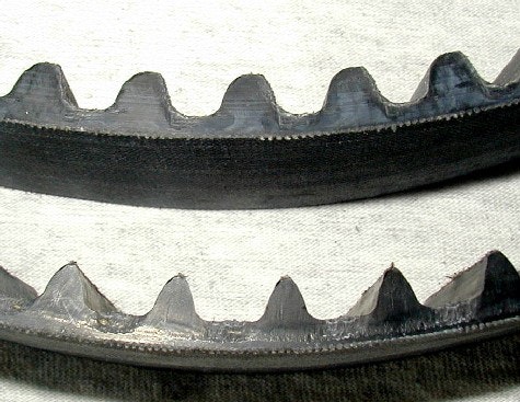

These drive elements don’t have to be retensioned because they exhibit less than 0.1% elongation in operation. But the “book” design life for these belt drives is about 12,000 hours. This assumes the operating conditions, such as properly aligned sprockets and clean and dry operating conditions, are ideal. The belt shown in Figure 2, on the other hand, lasted only six months because it was operated where abrasive dust was present.
Figure 2: This belt lasted only six months when it was operated in a dusty environment.
If you need a synchronous belt to last as long as a V-belt designed to the same standards, add 0.4 to your design service factor. In addition, most synchronous belt designs are sensitive to sprocket support rigidity. Deflections or misalignment that would have almost no effect on a V-belt can cause substantial life reductions in a synchronous belt. Switching from one type of belt to another always involves performance trade-offs. Book designs don’t allow for reverse bending with either belt type because it greatly increases the tension member fatigue stress, which shortens belt life.
