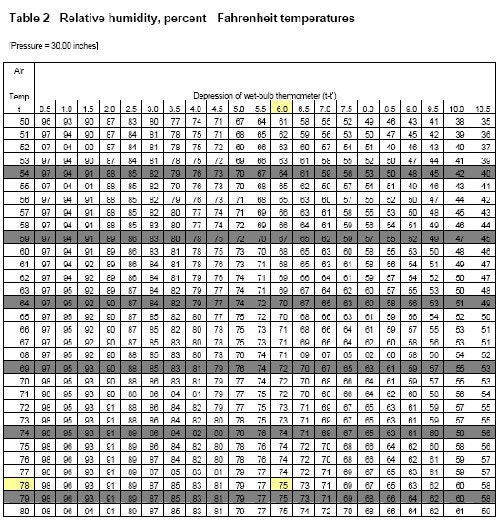

Humidity
Good painting practice dictates that the surface temperature of steel should be at least 5°F above the dew point during coating application to prevent moisture from condensing on the wet paint. Some zinc-rich coatings and moisture-cure polyurethane coatings require a minimum humidity to cure. Other coatings cure slowly in high humidity.
The temperature at which dew forms is called the dew point. Absolute humidity is a measure of the amount of water in the air. It’s usually measured as weight of water (grains) per unit volume of air (cu ft). Grain is a unit of weight having the abbreviation gr.
Historically, a grain was the weight of a grain of wheat, about 65 milligrams. Be careful not to confuse grains (gr) with grams (g).
Relative humidity (RH) is the ratio of the actual amount of water in the air to the maximum the air could hold. RH is a function of temperature and pressure, and is expressed as a percentage. Saturated air can hold no more water, and its relative humidity is 100%.
The temperature of the air closest to a steel surface, for example, in the bottom of the pits of the profile, will be equal to the temperature of the steel. If the temperature in the pit is slightly lower than the bulk air temperature, water can condense in the steel pit. That’s why the surface temperature should be greater than the dew point before paint application to provide a safety margin that avoids moisture condensation.
Hand-held electronic gauges have been developed that will measure surface temperature, air temperature and relative humidity. The device most commonly used to measure dew point and relative humidity is the sling psychrometer, which consists of two thermometers that are twirled through the air. The bulb of one thermometer is covered by a wet muslin cloth. As air movement causes the water in the muslin to evaporate, it absorbs heat from the bulb, thereby cooling the mercury in the wet-bulb thermometer. It will give a lower reading than the dry-bulb thermometer. This temperature difference is called the temperature depression and is used to find dew point and RH.
If the RH is low, water evaporates from the wet bulb quickly, resulting in a large temperature depression. When the ambient air is saturated, no water will evaporate and the two temperature readings will be the same, giving a temperature depression of zero.
Psychrometric tables relate temperature depression to dew point and relative humidity.
They were first published by the U.S. government in 1900 and are now in the public domain. Copies can be obtained from suppliers of inspection equipment or can be downloaded from www.srh.noaa.gov/elp/psych/psych.html [no hyphens]. Because the formulas for computing these quantities are quite involved, the practical solution is to resort to tables.
Air pressure also affects dew point and relative humidity, so the tables are constructed for various atmospheric pressures (inches of mercury). The contemporary metric unit for pressure is the Pascal (Pa). One millimeter of mercury is equivalent to 133.32 Pascals. A pressure of one inch of mercury is equal to 3.386 kPa.
You can use this information to determine if ambient conditions are suitable for applying paint. For example, assume that conditions at a job site include a barometric pressure of 29.8 inches of mercury, an air temperature of 78°F, a wet bulb temperature of 72°F and a surface temperature of 81°F on the steel. What is the dew point? What is the relative humidity? Are conditions suitable for applying paint?
The first step is to compute the temperature depression of the wet bulb, which is 78°F - 72°F = 6°F. Because the tables are based on integer inches of mercury, use the tables for 30.0 in. of mercury. Enter Table 1 with the air temperature (78°F) and depression (6°F) to find a 69°F dew point.
Then, enter Table 2 with the air temperature (78°F) and depression (6°F) to find a 75% relative humidity. The difference between the surface temperature and the dew point temperature is 81°F – 69°F = 12°F, which is greater than 5°F, so the conditions are suitable for paint application.
