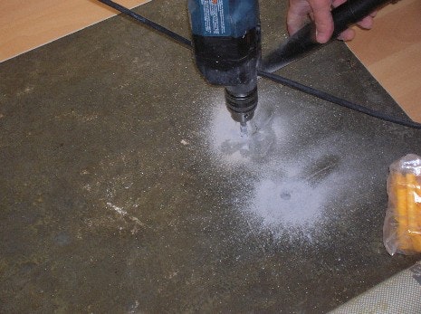

Getting that data requires using ASTM F 2170, Standard Test Method for Determining Relative Humidity in Concrete Floor Slabs Using In-Situ Probes. This is probably the best predictor of future moisture problems (Figure 2). It involves drilling holes in the floor to measure the humidity inside the slab. This is truly the latest technology for moisture testing and is very quickly being recognized by flooring manufacturers throughout the world.
Figure 2. Drilling a hole is the first step in testing with ASTM F 2170.
