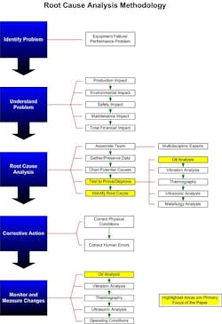

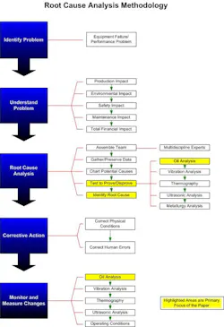

    Root cause analysis (RCA) is a tool to address reliability and chronic maintenance problems. It’s a systematic methodology designed to find and deal with sources of problems. That’s why the plant professional needs to understand the role of oil analysis in root cause analysis and in particular, how to use oil analysis to identify causes of accelerated oil degradation.
    RCA often is applied improperly in lubrication problems because analysts make assumptions without having supporting technical data. You’ll also need to know the fundamentals of performing a successful root cause analysis with respect to fluid degradation.
    The objective of a RCA is to identify what happened, why it happened and what can be done to prevent it from happening again. It involves examining the problem and considering evidence from as many other technologies as possible (Figure 1). Vibration analysis, thermography, ultrasonic analysis, metallurgical analysis, equipment/component inspections and operational data are valuable information sources when investigating a problem.
