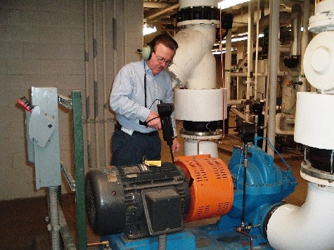

Airborne ultrasound is an acoustic frequency that a human ear can’t hear. Human-audible sound ranges from 20 Hz to 20 kHz, with the average being approximately 16,500 Hz. Airborne ultrasound allows us to hear sounds in the 20 kHz to 100 kHz range. A transducer mounted in either a scanning module (used for airborne sounds) or a contact module (used to touch an object) captures the sound and transfers it to the instrument. Through a process called heterodyning, the inaudible signal is converted into a frequency that we can hear through headphones. Also, the sound intensity (in decibels) is displayed on the instrument’s meter. The unit has a compact flash card to record sound wave signature.
By either touching the instrument to a test spot or pointing it at a target, you can hear the ultrasonic sounds through headphones and determine the source on the basis of intensity. The advantage of using ultrasound is that the source of the ultrasonic sound is fairly directional and can be easily identified with little interference from competing sounds.

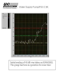

When trending bearings, it’s essential to establish an initial baseline reading. The first reading is my baseline. The best time to take the initial reading is when a motor, fan or pump is new.If the equipment has been in service for some time, you can still take your initial readings. If there’s more than one piece of identical machinery, compare the readings from each at the speed and under the same loading. Then, use the lower readings as your baseline. It doesn’t matter if the equipment is new or old, the important thing is to start a trending program. Some ultrasonic units have software that allows you to change the baseline after an overhaul or equipment replacement.

Repeatability is an essential part of trending. Select a location on the equipment to take your reading. Mark the spot with a dab of paint so you can take future readings at the same location. Pay close attention to the contact pressure you apply, and approach from the same angle each time. Set the ultrasound instrument range at 30 Hz.
I follow the same route through the plant when collecting vibration data. Whenever I take a vibration reading, I also take an ultrasound reading. I save the decibel reading, and if I notice the bearing is emitting an unusual sound, I record it for later playback and analysis with the software.

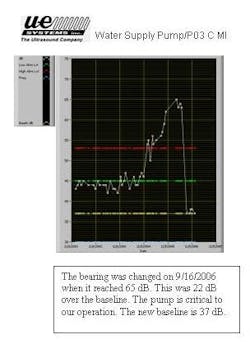

When I return to the office, I download the data into the software, which saves the readings, the date and time they were taken and the sound wave recordings. The software allows me to both hear and see the readings I took. Once I establish a baseline, I can trend the readings and compare each new reading to the previous reading and the baseline. A current reading that exceeds the baseline by eight decibels is a sign that the bearing lacks lubrication. At a difference of 12 decibels, you can expect minor damage and microscopic faults. When you reach a 16-decibel difference, damage is visually apparent. And a difference of 35 decibels or more indicates catastrophic failure.
Better software provides a choice of charts that you can graph: date, time, decibels, low-level alarm, high-level alarm, rpm, temperature, frequency and more. I normally set my low-level alarm at eight decibels over the baseline. My software automatically sets the high-level alarm at twice the low level.
The program allows us to watch what a particular piece of equipment is doing. We can adjust the alarm level to whatever suits our needs. If a reading exceeds the low-level alarm, the date at which it was taken turns yellow, alerting us that this is something to watch more closely. If the high-alarm level is exceeded, the date turns red, which also gets our attention.
When you locate a problem, initiate a maintenance request to repair the equipment. Including a trend chart in a report shows why a machine should be taken offline. And with trending, you can prove you didn’t miss something; you have the records to prove it.
After you make the repairs, take another set of readings to ensure the problem has been corrected and to reset your baseline. However, don’t delete your earlier data. It provides a valuable history. If a problem repeats, you can check the history. If the problem persists, you might decide, for example, that the application, not the bearing, is at fault.
