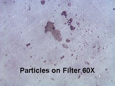

Preparation requires that a representative oil sample be thoroughly homogenized and diluted with a suitable solvent. The analyst will need either to have prior knowledge about the sample or to screen it to determine the best volume to use (usually 1 ml. to 3 ml.) to optimize the capability of the automated functions. Then, the diluted sample is drawn through a low-contrast filter of appropriate pore size, such as an 0.8-micron polycarbonate filter (Figure 1).
Figure 1. Sample prepared on 0.8-micron polycarbonate filter for automated feature analysis (AFA).
Extra care is taken in handling, indexing and storing the filter so that, if desired, the specimen can be reanalyzed at a later date and the same core automated data can be used to search out and further analyze particles.
