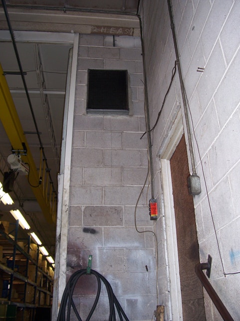

Sometimes, simplicity is the best way to go. In the plant shown in Figure 2, the air compressor is close to the loading dock. All that was needed to recover compressor heat for the dock was a short duct run vented into the dock area.
More comfortable dockers
Figure 2. Ducted heat from a nearby compressor improves working conditions at this loading dock.
