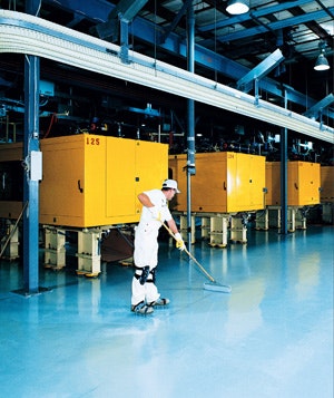

Floor coatings look identical in the bucket. However, it's not until they are applied and exposed to the abusive conditions of a plant that the quality of their chemistry becomes apparent.
Recent technological advancements in floor coating chemistry have resulted in premium, high performance products with increased durability and service life. Once applied, the benefits of these advances  become obvious.

Photos: Tnemec Co.
