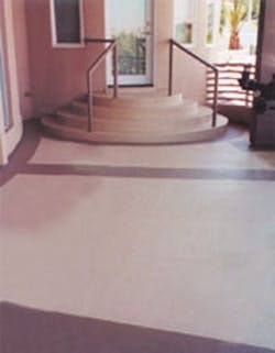

Polyurethane foams can be applied in multiple adjoining sections, which appear to be seamless.

In addition, polyurethane-elastomers enhance artistic choices for using coated surfaces in new ways, either exposed or with decorative coverings. These hard coatings are especially durable because they are 100% solid and can be applied in thicknesses that will survive for years. Like polyurethane foams, they are monolithic, so the material can be applied in multiple adjoining sections, which appear to be seamless.

Photo courtesy of SWD Urethane Co.
