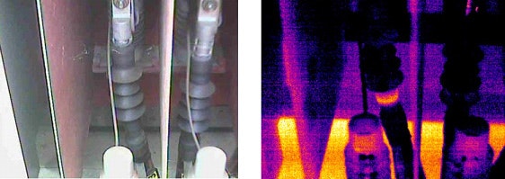

The initial IR survey, performed after equipment commissioning and startup, can identify problems related to improper installation. Figure 2 shows visual and IR images from an in-service startup survey. An improper installation of two of three terminators produced an abnormal thermal pattern.
Figure 2. A thermograph (right) of a 750 kcmil terminator on the left side of the cabinet shows excessive heat (yellow-orange color) below the fluted part of the insulator, indicating improper installation. The terminator on the right was installed correctly and isn’t overheating (the entire terminator appears nearly black).
Identifying this type of installation problem contributes to continuity of electrical service. IR surveys at startup also can identify the need for employee training that can prevent improper future installations.
