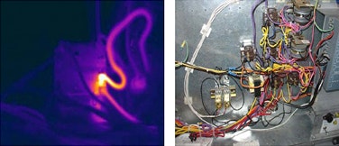

Reflections can be a problem when scanning highly reflective, low-emissivity targets such as bus bars. Adjust the viewing angle to avoid misleading reflections from nearby heat sources and from your own body (Figure 1). Reflections can produce an erroneous thermal image. If not understood, it becomes a data error.
Figure 1. Reflected heat from a transformer (lower left in visual photo) onto the target (upper right in visual photo), appears as an elevated temperature in the thermal image (left view).
