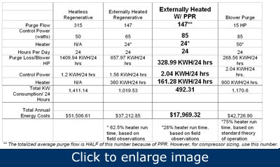

In order to qualify for energy rebates, the New York State Energy Research and Development Authority (NYSERDA) required a proposal that outlined projected energy savings. The dryer projections are below:
Although the projections focus on just PPR, the dryer was also ordered with dew point demand controls.
The result of the installation was a massive reduction in the amount of air and energy used in the compressor room. The dryer is currently running 61% in demand mode, and the heater run time is 15%, resulting in an actual and realized energy savings of $40,841.61 compared to a comparably sized heatless dryer. Additionally, because of the lower purge demand, the customer was able to shut off one of the 150 HP compressors, saving an additional $68,000 per year.
