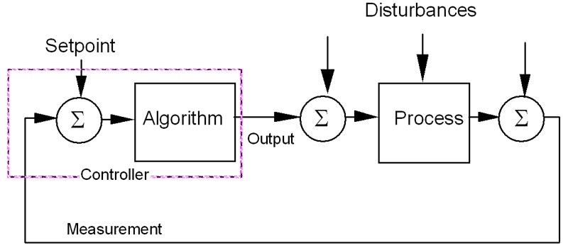

Process control refers to measuring a process variable, comparing it to some setpoint and manipulating the process in a way that keeps the process variable at its setpoint when either the setpoint changes or a disturbance changes the process. An example is shown in Figure 1. The temperature of the water leaving the heat exchanger is to be held at its setpoint by manipulating the flow of steam to the exchanger using the steam flow valve. In this example, the temperature is the measured or controlled process variable and the steam flow (or the position of the steam valve) is the manipulated variable.

  • A sensor to measure temperature, liquid level, pressure, flow rate or other variable, and convert the reading into a signal (typically 4 ma to 20 ma).
  • A control algorithm that calculates the output signal to be transmitted to the final control element.
  • A final control element that could be a valve, damper, motor speed controller or other device. It receives a signal from the controller and manipulates the process, for example by changing the flow rate of some material (Figure 2).
Figure 2. Interconnection of the control loop elements.
 Most control systems allow the operator to place individual loops into either manual or automatic mode. In manual mode, the operator adjusts the output manually to bring the measured variable to the desired value. In automatic mode, the control loop manipulates the output to hold the process measurements at the desired value.
