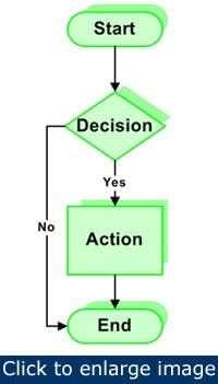

Every business process has a defined start and a defined end (oval blocks). In the most simple case, there are no interconnections to other processes.
Figure 2 shows an analysis of a one-step business process. The process starts; a decision (diamond block) is needed. The positive decision (Yes) results in an action (rectangle) while the negative (No) decision ends the process.

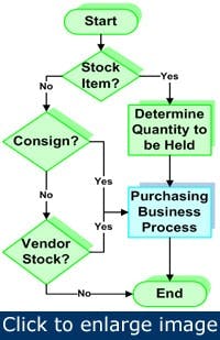

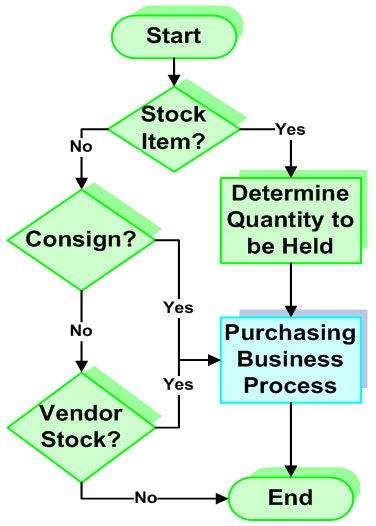

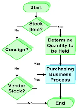

The reality looks more like Figure 3. Note the purchasing business process is not defined in this map. Determining the number of items to be held in inventory is a separate analysis involving a number of factors (lead time, cost, criticality).
Where to start
Figure 3: Expanded process

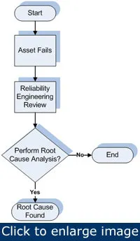

Figure 4 is an as-is business process for selecting asset failures to be analyzed to find their root causes. Note that finding the root cause is an endpoint in this example.
How well does this process map answer the questions? There are endpoints defined. End and Root Cause Found and no other business processes are noted. The only roles and responsibilities shown are for the reliability engineering organization (decision block). A recent decision not to perform a root cause analysis (RCA) has cost $500,000 in repairs and production downtime for a second failure.
Continuing the analysis
Figure 4: As-is process map. It’s based on the answers to the questions and there are a number of possible enhancements to the business process flow that should be considered.
