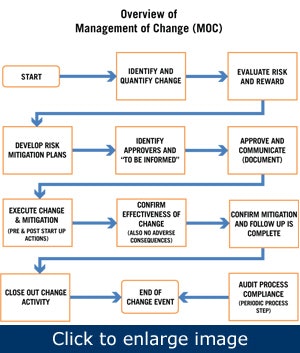

Although implementation details vary widely, truly effective management of change (MOC) programs start from the same foundation and contain the same basic elements, either singly or in combination. The following 11 steps give you the basic functional guidelines.
1. Identify and quantify change
What am I really planning to do here? Quite often where no effective MOC process exists, requests for a change are rather vague: “run a temporary line from here to there,” accompanied by some hand waving. It happens all too often. How big should the pipe be? What pipe material spec? What size and expected flow? Exactly where should it terminate? How about valves? You need simple sketches, red-lined drawings, marked-up procedures or whatever is necessary to convey the nature and extent of the change to a knowledgeable and competent third party. Be clear, be concise, but be complete. If you can’t communicate clearly what it is that you wish to do, how can a team evaluate it properly and how can you ensure that what you intend to do will in fact be implemented properly? At this point in the process the change must be defined well enough that you can make a good decision in subsequent steps.

9. Confirm mitigation and follow up
Figure 1. The most critical MOC question to ask is: “Should I make this change at all?” Avoid unintended consequences.
