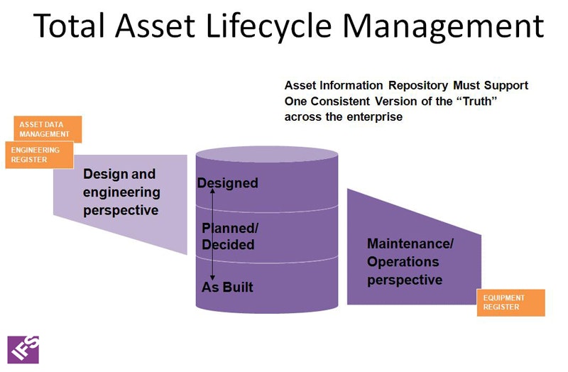

In this section, the PAS states that an IT system shall address all phases of the asset lifecycle, including the upfront processes of planning and engineering the asset, its construction, ongoing maintenance and operation and its eventual retirement or decommissioning (Figure 1).
Figure 1. PAS 55 dictates that an IT system shall address all phases of the asset lifecycle.
One of the most important aspects is the requirement that the IT systems used must support an accurate and consistent view of all asset information — one version of the truth — ensuring policies, plans and actions are based on an accurate understanding of the history and current status of your asset infrastructure — very hard to manage in disparate applications across a corporation. In fact, it is equally difficult to accomplish this with an EAM software package that does not address the requirement to support the initial engineering, construction and project management phases of the asset’s lifecycle. Engineering, construction and project management functionality is not traditionally included in most EAM solutions on the market today.
