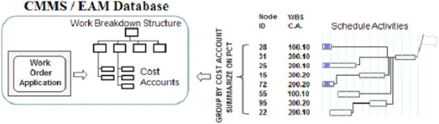

The WBS can be connected to schedule activities through the cost account as a many-to-one relationship. The objective of a WBS is to identify the deliverables, but not to make it as detailed as a schedule. A project schedule however contains substantial detail, including logic ties, resource availabilities, constraints and durations. The scheduling also allows for critical path analysis and resource leveling. Schedule activities are usually at a lower level of detail but can be linked to WBS cost accounts. Using input from schedule in form of percent complete, you can calculate earned value, which is a true measure of where you are in the project. It is also possible to create a WBS solely within the schedule software.
The WBS also should be stored in the CMMS database. A WBS provides the best start to managing a project. By embedding the WBS inside the CMMS system you can easily connect work orders to cost accounts. Upper management typically wants to be informed of project status from the cost perspective but does not want to see a detailed schedule or list of work orders. The overall benefit is enhanced cost control through project cost tracking.
Most shutdowns require detailed scheduling and critical path management. Larger projects also benefit from a WBS connected to a schedule (Figure 2). Work selected for the outage gets downloaded to the schedule. Once the project starts, daily progress is captured against the schedule, whereas actual hours go against a CMMS work order to feed WBS. Schedule activities can be summarized by cost account providing progress summary to the WBS.
Figure 2. The schedule determines the cost, which integrates with the CMMS
