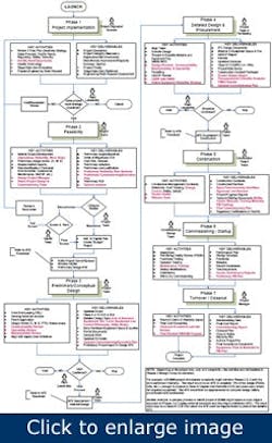

The number of phases depends, in part, on the process for obtaining the authorization for expenditure (AFE) at each company. It is probable that a project may not reach the approved stage for final expenditures until some preliminary design and costing evaluations are completed. The assumption is made that the seven phases will be used (Figure 1). Capital project tasks that impact reliability are identified with colored text in the figure. Managing the project for reliability begins with ensuring there are sufficient resources to optimize reliability.
The seven phases used to support reliability are:
  1. Project initiation
  2. Feasibility
  3. Preliminary/conceptual design
  4. Detailed design and procurement
  5. Construction
  6. Commissioning/startup
  7. Turnover/closeout
