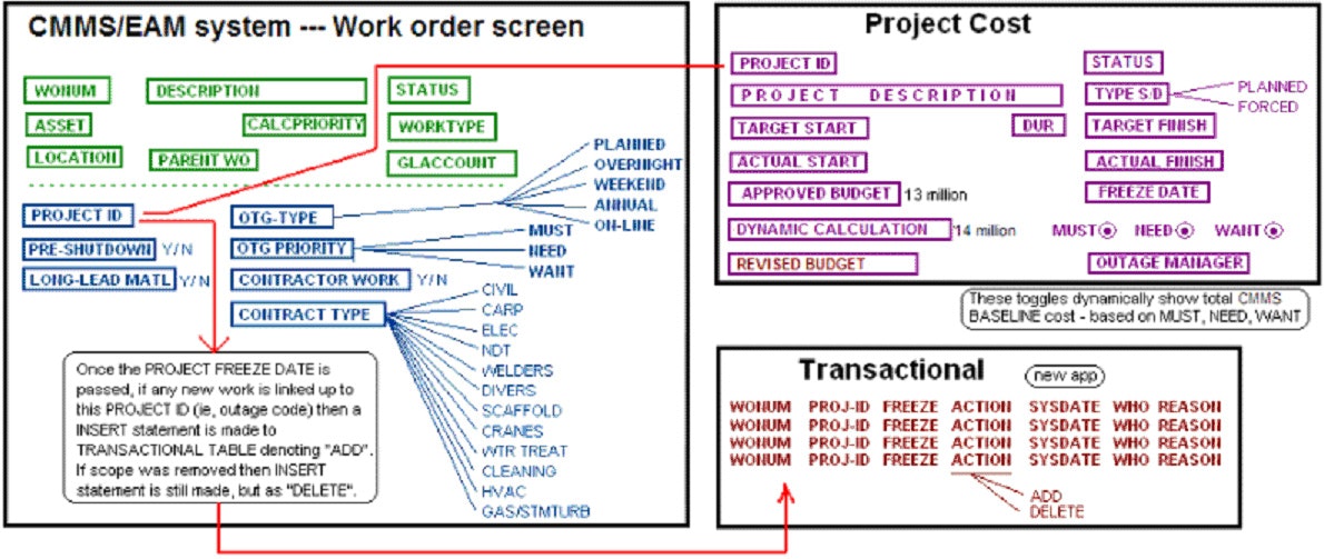

Outage preparation is important. If this process is to function, any potential outage work must be properly categorized and planned within the CMMS(Figure 1). Important milestones in an outage timeline are:
  • outage scope objectives and mission statement
  • start date and duration
  • CFO budget delivery
  • scope finalization
  • freeze date determination
  • outage start
  • outage completion and assessment
  • reporting to CFO on outage success and cost overruns.
Once the CFO provides the budget for a planned outage, the project coordinator sweeps up the work coded for this shutdown, assesses the schedule duration and identifies the total cost. If it exceeds the budgeted value, some work must be cut. The goal is to come close to the budget without exceeding it by selecting high-priority work, within scope objectives, that provides most operational benefit.
Figure 1. The freeze date should be recorded in the CMMS such that any scope additions can easily be tracked.

  • capture scope changes via transaction tracking automatically (There are three types of changes — scope alterations after the freeze date, dollar movements within the project and project cost revisions. The scope alterations can be captured automatically once the freeze date is in place.).
Allow for outage scope/cost refinement
Enable what-if cost refinement when specifying the scope. Some of the scope is must-do, but other parts are optional. This approach allows for dynamic scope selection and immediate visibility of the calculated dollar total, which is then compared to the budget cap. Minimize any deviation by changing the selection criteria or changing individual work order priorities. The screen design shown in Figure 2 shows the what-if design capability that allows for dynamic cost balancing. There’s also an automatic capture of scope changes in a transactional table.
Figure 2. Manage scope and cost through work-order tracking.
