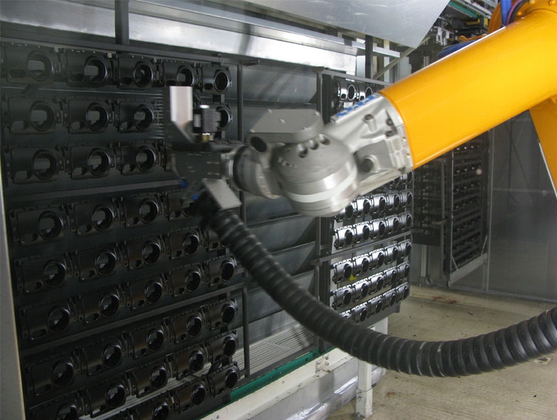

The CO2 snow jet system has been integrated into a large paint booth measuring 5.5 x 4 x 3 m together with a turning station. (Source: Volkswagen, Plastics Technology, Braunschweig)

The modularly constructed CO2 snow jet system achieves its effective cleaning power via the supersonic two-component ring nozzle integrated into the compact cleaning head. Liquid carbon dioxide is guided through the nozzle and expands on exit to form a mixture of snow and gas. Oil-free compressed air is fed to the core jet as a jacketed jet, accelerating the non-toxic, non-combustible CO2 snow crystals to supersonic speed. When the jet impacts on the surface to be cleaned, the snow crystals liquify and then sublimate. The sublimation impulse causes any particulate contamination present to detach and be carried away. In the liquid phase, carbon dioxide also acts as a solvent which removes organic contamination. At the same time, the low degree of hardness of the snow crystals is designed to ensure gentle and reproducible cleaning results on the high-gloss surface of the component. “During the test phase we also carried out test series with other components made of different materials,“ reports Strauss. “This proved that the CO2 cleaning process can be implemented for our entire range of workpieces.”

Component-specific cleaning programs are filed in the robot controls for approximately 20 different workpieces. To prevent recontamination, all dirt which has been removed is extracted. (Source: Volkswagen, Plastics Technology, Braunschweig)
In line with Volkswagen Plastics Technology requirements, ACP designed a robotic cleaning system with a nozzle array containing seven cleaning heads. The component-specific programs filed in the robot controls ensure that each of the approximately 20 different workpieces is cleaned fully and automatically, according to its geometry. Oil-free compressed air and liquid carbon dioxide stored in tanks are fed to the array via a hose system.
The robot installation is integrated into a booth measuring approx. 5.5 by 4 by 3 m. The cleaning cell located at the rear wall has a continuous extraction unit. This prevents cleaned parts from becoming recontaminated by dirt as it’s removed. A turning station, which can be switched on separately, is located in the booth downstream of the cleaning process, allowing suspension gear to be rotated by 180°. “ACP provided us with ideal support both during the test phase and afterward, when we started implementing the cleaning system, enabling us to integrate it into the painting process within the space of just three months,” says Strauss.
