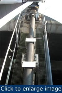

It's a long way to the top if you want to align cooling tower fans with spacer shafts.
Figure 1. In this cooling tower spacer shaft configuration, the distance from the motor to the gearbox is more than 12 ft.

Several configurations of cooling tower fan drives exist. A spacer shaft doesn’t need to be treated like a separate machine because it isn’t. It has no bearings or support mechanisms of its own. It must go where the driver and driven shafts take it. If you do happen to have a long spacer shaft with a center support bearing, the center support bearing must be treated like an additional machine component, and aligned as a machine train.
Spacer shaft alignment has two unique aspects. First, the amount of alignment correction at the motor can seem to be very large. While the distances across the coupling faces may be only a few inches, the faces of the couplings, and the shafts, form right angles. So the angles extend for several feet back to the motor or movable machine. When the distance between the driver and driven machines is several feet, the correction amounts at the motor feet can be ¼ in. or more, but the offset and angularity at the couplings may be within tolerance (Figure 1).
Second, you are correcting two angles, one for each coupling. There is really no offset, or parallel correction. If you get all four coupling faces aligned, the spacer shaft will go along (Figure 2).
