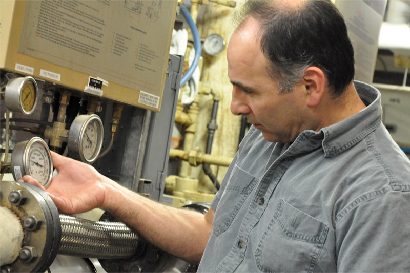

Figure 2. Technician reads the gauges on a Clayton Industries boiler.
Clayton Industries has similar concerns (Figure 2). “Most often our schedule interruptions are customer-driven,” says Smith. “If there is a production change that interferes with scheduled maintenance, we’ll reschedule the PM to a later date. If a boiler breaks down, it becomes our top priority.”
