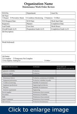

Table 1. When maintenance planning and the computerized maintenance management system (CMMS) are both parts of the maintenance department, these relationships can drive efficiency.

  • Audit maintenance efforts for the month and check off the availability and quality of each element for each maintenance work order as it’s performed. This will require temporary assignment of a qualified person for the assessment. Maintenance planners are good candidates, as long as they’re working outside their own territories.
  • Determine the quality of the maintenance effort that was performed against each order by answering seven questions.
    1. What kind of job was it — repair, preventive maintenance, condition monitoring, asset integrity/statutory?
    2.  How much lead time was available to plan and organize the effort?
    3. Were all elements in place at execution?
    4. Which elements, if any, were missing?
    5. Was the job done completely and permanently?
    6. Were follow-up orders required?
    7. Was the problem, if any, solved at a root-cause level, or will it be back again?
    • Once a collection of orders begins to accumulate, assign a grade (A to F) to each completed work order.
    • Hold weekly meetings to discuss the strengths and weaknesses of the effort to complete each work order, using the same elements to provide a framework for the reports.
