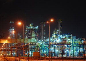

Figure 2. Technologically advanced coatings have been formulated to meet the demanding needs of industry, including petrochemical plants.
