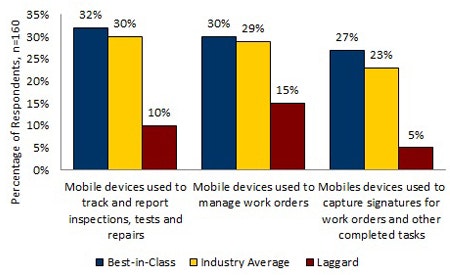

Mobility enablers are increasing in scope and value
When handheld devices are linked to asset management software, they provide portability and visibility into distributed asset management. “Adding mobility to asset management software aids in workforce productivity. You can use a mobile device to enter a work order for in-house maintenance, or send a maintenance request. There is some adoption in this regard, but it is relatively small. Companies need to adopt this in order to be more predictive, with more stability of data,” advises Aberdeen’s Ismail (Figure 2).
Figure 2. While best-in-class companies are more likely to invest in asset management solutions, they are also more likely to empower their employees with mobility tools. (Source: Aberdeen Group)
Thanks to recent technology improvements, smart devices are providing a wider scope of functionality that is capable of being introduced to a broader range of industries.
“Today, commodity products like Microsoft Windows 8 and RT, Microsoft Surface, Google Nexus and a range of smartphones can be combined with commodity software to make mobility accessible to more industries than ever before,” says Rakesh Verma, president of Parijat Controlware (www.parijat.com). “End users in electrical and water utilities; oil and gas drilling, refining and pipelines; chemicals; and transportation are benefiting from this technology. Mobility solutions for control systems have been around for several years. Now there are solutions in place using iPad units that are Class I, Division 2-certified for use in hazardous environments,” adds Verma.
