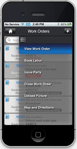

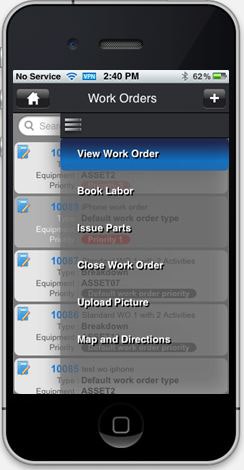

Asset management software: DMMWRA matched its asset management software to its business objectives. “We implemented maintenance best practices here a few years back, and we set up and configured our enterprise asset management (EAM) system around those best practices,” says Miller. The EAM solution is sustainability-focused and incorporates reliability-centered maintenance (RCM), condition-based maintenance (CBM), energy consumption monitoring (ECM), facility condition assessments, root cause failure analysis (RCFA), and geographic information systems (GIS). DMMWRA also integrated its EAM, process control system, and data historian, allowing reporting of integrated data.
The maintenance organization is paperless, says Miller. Employees either use a smartphone or iPad to access EAM information or go back to the storeroom or to one of the zero-client computer centers located throughout the site.
“Our storeroom is picture perfect,” says Miller. “All assets and parts are barcoded and have priorities and criticality ratings, and they are broken down by type. The asset parts list shows all quantities in the storeroom and whether we need to order more.”
