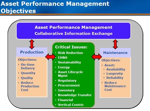

APM solutions provide a broader recognition of operational risks and liabilities, and the interdependencies in O&M activities. (Source: ARC Advisory Group)

“When people have access to the same information, in the right context, they collaborate more effectively,” says ARC’s Hollywood. She encourages organizations to adopt an asset performance management (APM) framework for sharing asset information because neglect in this area puts organizations at risk of operational, safety, and compliance violations, as well as cross-functional conflict.
APM systems align O&M with organizational goals. “They provide a broader recognition of operational risks and liabilities, and the interdependencies in O&M activities,” says Hollywood. “Sharing information across all APM stakeholders, whether internal or external to the organization, allows you to better manage issues that constrain performance and avoid the potential costs of non-compliance with new government regulations.”
