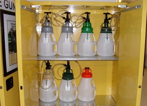

Figure 3. Transfer containers and labels make storage and transferring of lubricants simple and intuitive.
So far, we’ve seen fewer facility breakdowns since we implemented the new lube management system. The containers and labels make everything clear, so operators are recognizing potential issues faster and at a higher rate. Operators are now looking at their equipment, identifying issues and submitting work orders just because the oil doesn’t look like it should. Over the past three-and-a-half years, I’ve seen two or three work orders. We’ve had as many as 15 work orders submitted in the past few months since implementing the lube management system.
The lube management system is showing the greatest benefit with its custom colors, shapes and labels. Before, it was a guessing game. Now, each oil is in a different container with a unique color characteristic (Figure 3). The equipment is tagged, the container is tagged, and the source is tagged. The lubrication process is essentially fail-proof.
