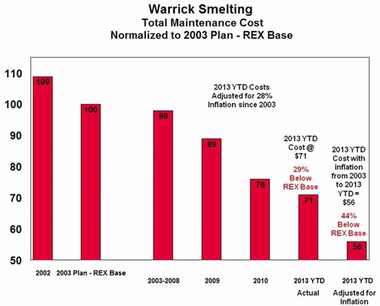

Figure 2. Alcoa Warrick Smelter’s R&M costs are 29% below its 2003 pre-REX base and OEE performance improvement gains are worth another $9.5 million annually.
In 2003, Alcoa’s aluminum smelter east of Evansville, Indiana, was 43 years old and had the second highest maintenance (R&M) costs in the Alcoa Smelting System. Asset reliability in the plant continued to suffer, and equipment instability was holding lean manufacturing gains hostage. A formal assessment of the smelter’s R&M efforts determined a mostly reactive approach with a focus on trying to be really good at emergency breakdown response.
With strong sponsorship in 2003, the location embarked on a reliability excellence (REX) transformation. Ten years later in 2013, Alcoa Warrick Smelter’s R&M costs are 29% below its 2003 pre-REX base — 44% lower adjusting for inflation —and OEE performance improvement gains are worth another $9.5 million annually (Figure 1). A formal asset integrity audit performed by corporate-level resources in late 2010 determined that the Alcoa Warrick Smelter had the lowest percent of corrective actions needing attention in the next five years versus all other Alcoa smelters worldwide (Figure 2). This audit confirmed that cost savings gains were not from R&M deferral.
Figure 1. Operations-production played a key role in the success of reliability excellence at Alcoa Warrick Smelter, dropping normalized maintenance costs significantly over the past 10 years.
