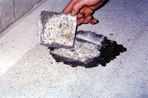

Once the substrate is cleaned, prepared and dried properly, bond tests determine the adequacy of substrate preparation. Bond tests mix quartz sand and a small batch of the selected primer system and apply it in palm-size patties 1/8-inch to 1/4-inch thick at various locations throughout the job site. After one hour, the patties must cure tack-free. They are then removed with a chisel and hammer.
The entire bond test area should show only concrete with fractured aggregate attached to its underside. If only laitance, fines or a small amount of concrete is attached, or if interface between patty and substrate is tacky, further substrate preparation is required. Proper tests help ensure that the bond will be deep and long-lasting bond (see Figure 2).
Figure 2. This is an example of a complete, successful bond test. The entire bond test area shows concrete with fractured aggregate attached to the entire underside.

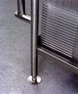

Figure 4. A close-up of acrylic reactive resin colored quartz floor,notice its textured, slip-resistant finish.

Generally, MMA-based acrylic reactive resin systems are installed resin rich and, therefore, are free of pores and voids throughout the entire thickness. This results in an impervious, waterproof finish that protects the underlying sub-floor from damage. Liquids, solids, oils and other industry-related substances cannot penetrate into the floor and are cleaned easily in a variety of ways, depending on surface texture and environment.
