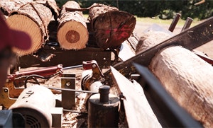

Figure 1. The sawmill in Prospect, Tennessee, employs 15 people.
ProMark, a subsidiary of D'Addario, has changed the beat of the drumstick manufacturing process. D’Addario, a family-owned and –operated company headquartered in Farmingdale, New York, with more than 1,100 employees, manufactures 95% of its products — including D’addario strings, Evans drumheads, ProMark drumsticks, PureSound percussion accessories, Rico reeds, and Planet Waves cables and accessories — in the United States. The company owns its own sawmill in Prospect, Tennessee, about 7 miles north of the Alabama border, which supplies materials to its drumstick plant in Houston, where D’Addario produces 15,000-16,000 sticks per day. The sawmill, with its 15 employees, has adopted the quarter-sawn manufacturing method to improve quality and consistency in all ProMark drumsticks (Figure 1).

ProMark is the only drumstick company that owns its own sawmill and is purchasing its own logs (Figure 2). “While the sawmill is important, the knowledge of the people we employ at the sawmill is even more important,” says Rick Drumm, president of D’Addario (Figure 3). “We actually select our own logs. We’re looking for logs that are going to give us the greatest yield of the white sapwood. We use four different species of American hickory to produce the sticks, and we’re looking for logs of a certain type and size. With the mill, we’ve invested quite a bit over the past year-and-a-half to rebuild the infrastructure, making sure the mill is safe and also looking at improving our output.”
The company is now also using a method to saw logs that is revolutionary in the drumstick industry.  In the quarter-sawing method, the log is literally cut into four quarters. The log is cut vertically and then turned and cut again, so the grain line is straight up and down.
