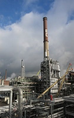

The INEOS chemical plant in Cologne, Germany, was shut down for two months for maintenance activities in a turnaround project with an investment volume of 100 million euros and involving 6,000 people. TÜV SÜD Chemie Service accompanied the large-scale project — a feature on the testing and inspection practice on-site.
The day is cloudy. A spot of bright color catches the eye against the dully monochrome industrial architecture. A red crawler crane, 188 m high, stands out from the futurist labyrinth of scaffolding which encases the chemical plant. Higher than the Cologne Cathedral and with a mass of 927 tonnes, the crane is the largest item of mobile material handling equipment that has ever been used in a turnaround at the Cologne INEOS site. Over the next two months, the crane and other equipment will be used to find the answer to one question: Can the safe and reliable operation of the highly complex chemical plant be guaranteed for the next five years?
