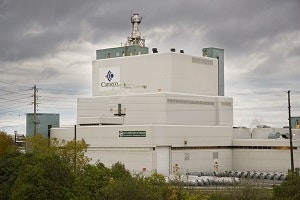

Cameco supplies uranium processing services required to produce fuel for the generation of clean electricity by operators of nuclear reactors. The company currently supplies approximately 25% of the world’s conversion capacity. Cameco is one of two fuel manufacturers serving Canada’s reactor fleet and the largest Canadian supplier of components for Canada deuterium uranium (CANDU) reactors — Canadian-invented, pressurized heavy water reactors. Cameco’s products and services are used exclusively for the generation of clean electricity by nuclear power plants.
Cameco’s Port Hope Conversion Facility (PHCF) in Ontario converts refined uranium trioxide (UO3) received from its Blind River facility into new chemical forms needed for production of nuclear fuel. The facility uses two separate processes to produce uranium dioxide (UO2) and uranium hexafluoride (UF6). UO2 fuels CANDU heavy water reactors and UF6 undergoes further processing outside of Canada before being used in fuel for light water reactors, both of which are used in the production of clean electricity by nuclear power plants around the world. The facility is licensed to produce 12,500 tonnes of uranium per year in the form of UF6 and 2,800 tonnes of uranium per year in the form of UO2. The facility was not operating at full capacity when it embarked on the reliability journey. While market conditions kept the plant from operating at full capacity, habitual reactive practices kept the plant from achieving the lowest possible unit costs.
In addition to the processing plant, PHCF houses technology development labs, an analytical services lab, and a power house that provides all the utility services for the site. Approximately 350 people are full-time employees, and 40 part-time and contractor employees are at the unionized facility located in Port Hope.
