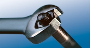

Threadlocking or machinery adhesives are a reliable and inexpensive way to ensure that a threaded assembly will remain locked and leak proof for its entire service life. These single-component anaerobic adhesives are applied to the threads of a bolt as a liquid, stick or tape. The adhesive fills the grooves of the threads and cures to a hard thermoset plastic when exposed to active metal ions in the absence of air. Machinery adhesives lock threaded parts together, ensuring that mating parts will ultimately act as one conjoined unit that resists failure and delivers the greatest possible reliability.
Figure 1. Threadlocker adhesives lubricate the assembly to reduce friction and torque load during fastener tightening. Source: Henkel Corporation.
Threadlockers fill voids 100 percent to lock the threads and maintain consistent clamp load over time. Prior to cure, these adhesives lubricate the assembly to reduce friction and torque load during fastener tightening (Figure 1). Post-cure, threadlockers seal the assembly to prevent corrosion and seizure, and ensure that disassembly is consistent and predictable.
