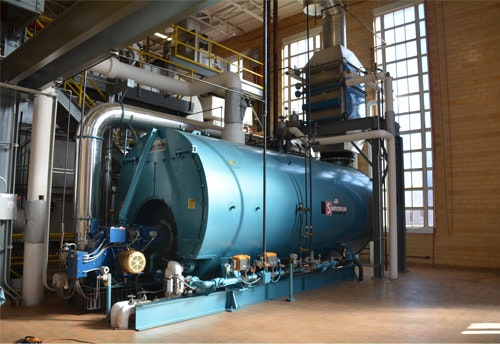

Firetube boilers offer competitive thermal efficiencies with and without economizers. Photo courtesy of RMF Engineering at Wake Forest University
