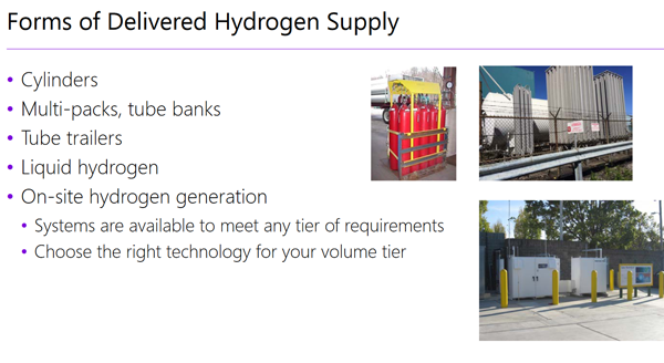

PS: How do I know if my operation might benefit by generating hydrogen?
DW: The types of issues that might indicate that it makes sense to look at generating your own hydrogen are: Do you have issues relating to hydrogen storage on your site? Is your landlord unhappy? Are your neighbors unhappy? Is the local authority having jurisdiction or the fire marshal unhappy? Are your employees unhappy? Or, is your site rented in which case you need to think about moving somewhere down the line and you're going to be hesitant to invest in that site?
Another suggested approach that indicates that hydrogen generation might be a good direction for you is if you're looking for cost certainty and cost reduction, so you can be certain of your hydrogen costs when you control both the equipment as well as the raw materials that go into making your hydrogen. Hydrogen generation can often supply a high purity grade of hydrogen at the same cost as a lower purity delivered. Finally, I would focus on space utilization. Customers find that hydrogen storage takes much more space than they had associated just with the equipment itself because of the requirements associated with NFTA 55, which is the hydrogen standard.

PS: What are the different technology approaches to generating hydrogen at my site?
DW: You've got to start with something that has hydrogen in it – we don't extract hydrogen from the air. Your two choices really are hydrogen from water, which is one form or another of electrolysis, or hydrogen from hydrocarbons, which is typically thought of as a steam methane reformer. Electrolysis uses electricity whereas hydrocarbon reforming uses hydrocarbon energy to run the process. In general, hydrocarbon reforming is for much larger hydrogen generation needs then would be of interest to most people on this phone call.
