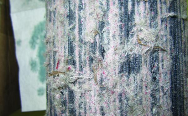

Case file: Why is my filter wearing a pink sweater?
A bottom roll hydraulic system was exhibiting high differential pressure across the lube oil filter. When the filter was removed, it was observed to be covered in pink, fibrous material (see Figure 1). The filter looked as if it were wearing a fuzzy pink sweater! The filter was sent to the laboratory in order to characterize the material. Upon arrival at the lab, close inspection revealed the presence of three distinct foreign materials captured in the filter media: a black solid material, a brown solid material, and pink woven material (see Figure 2). The pink woven material was the most abundant material present and was the primary cause of the plugged filter.
Laboratory analysis of the black material characterized it as polypropylene. The brown material was characterized as Teflon. The pink material was characterized as polyethylene terephthalate. Identification of the materials present allowed the investigative team at the plant to track down and confirm the sources of the material.
The black polypropylene and brown Teflon were traced back to seals and gaskets in the lubricating system. The pink polyethylene terephthalate was traced back to a welding rag, which had accidentally been dropped into an open hatch by a contractor working at the plant. Knowledge of the root cause of the introduction of the pink material that plugged the filter allowed the plant to develop better training for outside contractors to have a better awareness of their surroundings and be responsible for their materials.
