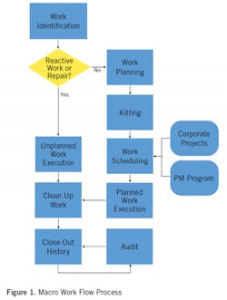

In 2019, the plant engineering department of McKee Foods Corporation in Collegedale, TN started an initiative to improve equipment reliability, which we called McKee Maintenance Excellence (MME). MME included many of the typical elements of a maintenance improvement program such as: Work Execution, Preventive Maintenance Optimization (PMO), Root Cause Analysis (RCA), and Precision and Predictive Maintenance. As we began to put together a plan on how to accomplish this, we quickly realized that we did not have standard processes to build on, and we needed to get our foundation right. This effort began by documenting how work was currently accomplished and comparing that to what world class looked like. Focus teams with people from departments across the company were put together to start building these processes (see Figure 1). Without these processes, there would have been nothing to train our people on nor anything to audit against later. This was by no means the most glamorous part of our initiative, but it was one of the most critical parts of what we did to start our journey.

Your finished product needs to be robust but as simple as you can make it. The harder the process is to follow, the less likely it is that your people will be able to execute it properly. However, the process does have to be robust enough that you can audit how your department is adhering to it. These are the processes that will serve as the foundation of your reliability program (see Figure 2). If all of these new processes are not followed, you will not achieve the desired result.
For example, if your department is not following the work identification process (the process on how work enters your work order system) then you cannot count on your planning and scheduling processes to work. This would look something like your maintenance technicians identifying work on the floor but not using a work request to get it into the work order system. They might simply write an emergency work order, gather their own parts, and do the job. Now if it is truly an emergency that could be perfectly fine, but we would expect that to bea communicated to supervision. If it was not truly an emergency then the technician will not be able to complete the work that had been assigned to them by the scheduler. You usually can see this in your schedule breaker metric if you have one.
