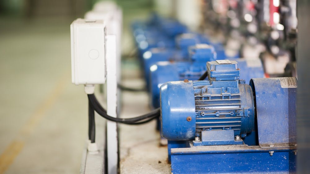

This month’s question: What can cause an electric motor to trip its overload protection device during startup?
Mike Howell, PE (Technical Support Specialist, EASA)
When a new AC motor trips its overload protection during startup, several factors could be at play, particularly related to starting methods and kVA code.
Starting methods. The starting method used can significantly impact the motor's performance. Common starting methods include direct-on-line (DOL), star-delta, and soft starters. DOL starters apply full voltage to the motor, resulting in high inrush currents that can cause the motor to trip if the electrical system cannot handle the surge. Star-delta starters reduce the initial voltage, but improper switching or timing can still lead to tripping. Soft starters gradually increase the voltage, minimizing inrush current; however, if these starters are not correctly configured, they can also cause issues. If the motor is inverter-fed from a variable-frequency drive (VFD), inadequate drive tuning could also prevent a successful start.
Motor kVA code. Another critical factor is the kVA code on the motor nameplate. Motors with higher kVA ratings (e.g., H vs. E) have higher starting (inrush/locked rotor) currents relative to horsepower that can exceed the capacity of the electrical system, leading to tripping. To prevent this, it is essential to ensure that the electrical system rating is adequate for the motor's kVA code.
Other issues. Besides an inadequate power supply, other potential causes for tripping on startup include incorrect wiring, faulty components, or mechanical problems such as excessive load or binding in the driven equipment (see Figure 1). Proper installation, configuration, and maintenance are all crucial to avoid startup tripping and ensure reliable motor operation.
