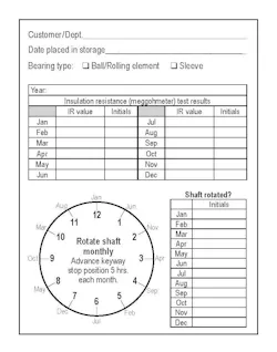

Monthly shaft rotation. An easy way to handle the first two concerns is to spin the shaft several revolutions each month. This redistributes lubricant on shaft and bearing surfaces and repositions the weight of heavy rotors. When maintaining multiple motors in storage, a simple way to accomplish this task consistently is to place all shaft keyways at the 12 o’clock position to start. Each month, rotate the shafts several revolutions, advancing the stopping point 5 hours on the clock face–e.g., 12:00 in January, 5:00 in February, 10:00 in March, and so on (see Figure 1).
This 5-hour increment system ensures even distribution of rotor weight over time, preventing permanent bowing in heavy rotors. It also repositions the contact points of rolling element bearings along inner and outer races, reducing the risk of ambient vibration damage. Additionally, it provides a quick visual check for maintenance completion–misaligned shafts indicate missed rotations.
