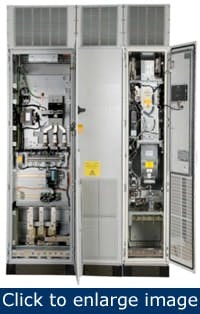

Figure 5. 400 hp drive with integral harmonic filter
The six-pulse VFD with integral harmonic filter is a standard six-pulse drive with the addition of a line harmonic filter integrated into the drive lineup. This configuration provides benefits such as a single enclosure, protection by the drive circuit breaker and fuses. The short-circuit current rating (SCCR) applies to the complete enclosed drive unit, and there’s no need for external protection upstream of the filter. Nor will you need extra power or control cabling for overload or temperature protection. (Figure 5).
The new line-harmonic filter (LHF) design features a reactor with zig-zag windings (windings from three phases on a common core) to provide some degree of harmonic cancellation. The reactor is combined with a small capacitor bank that results in a compact design, about 16 in. wide for 150 to 400 hp and 24 in. for 500 hp to 800 hp. The THID is approximately 8%, while the PF is unity at full load, capacitive at partial loads, which might present a difficulty on a weak supply network or with small backup generators, less than three or four times the drive rating. The harmonic limits might be exceeded with weak supply systems (Figure 6).
