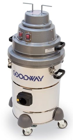

Goodway introduces dry-only explosion proof vacuum with HEPA filtration
The 120V, CSA-certified dry pickup vacuum is specially designed for picking up explosive powders like flour or sugar, spent shell casings or black powder residue.
Feb. 22, 2016
Goodway Technologies introduces the VAC-EX-120-5-SS. The 120V, CSA-certified dry pickup vacuum is specially designed for picking up explosive powders like flour or sugar, spent shell casings or black powder residue. The features continue with a 5-gallon capacity, easy-to-clean stainless steel tank and four swivel wheels to easily maneuver throughout the space while cleaning. It is certified for use in hazardous locations (Class II, Division 2, Groups F and G) and designed for recovery of flammable and toxic powders.
Features include:
  • Electric 120V, 60Hz, 1.6HP
  • Certified explosion proof/dust ignition proof
  • HEPA filter included with an efficiency of 99.995% at 0.3 micron
  • 5-gallon capacity
  • Stainless steel tank
  • Designed for the recovery of fine powders
  • Complete static dissipating
VAC-EX-120-5-SS Specifications:
  • Power Requirements: 11 Amps, 120 V, 60 Hz AC
  • Static Water Lift: 105"
  • Air Displacement: 105 CFM
  • Dimensions: 39"(h) x 19.5" (w) x 19.5" (d)
  • Weight: 54 lbs
  • Dry Capacity: 5 gallons
