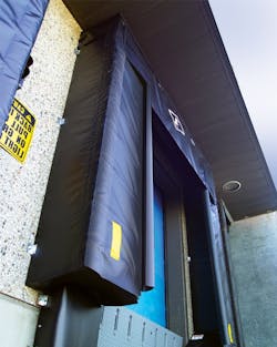

Exposed gaps around swing-out trailer doors create the equivalent of a 2 1/2 square foot hole in the dock wall that can cost a facility thousands of dollars in energy losses.

Seal things up: Semi trailers with swing-out doors leave gaps on either side of the trailer when they’re being loaded and unloaded. The gaps are equivalent to a 2.5-sf hole that allows air and conditioned air to flow in and out freely. Close the gaps with a dock seal or shelter that seals the trailer-door hinge gaps.
