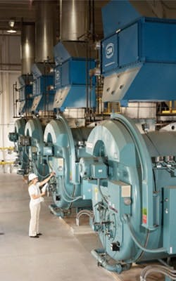

Figure 1. The criticality of steam quality varies by application, but the best way to alleviate steam-quality issues is to maintain the quality of the water. (Source: Cleaver-Brooks)

The best way to alleviate steam quality issues is to maintain the quality of the water, says Cleaver-Brooks’ Vasudevan. “Water has some impurities, like silica, dissolved salts, and organics,” he says. “To prevent impurities from water particles from being carried over, you need to use better quality water, monitor it on a regular basis, and maintain it within the industry standards for recommended water quality based on the steam pressures used.”
